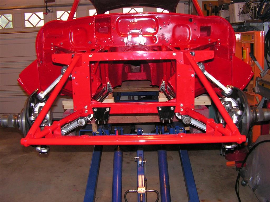

Slowly but surely it's time to start the final assembly. Today I set out the front sub-frames and collected all the plated hardware to begin the assembly of the front end.
The paint on the sub-frames was pretty thick and it required a little gentle scraping with a razor blade to make it fit in the lower mounts. As in any reassembly work, it's a hand tool only job to keep from damaging the paint around the fastener. That also means a limited use of sockets because the rotation and force will leave a ring on the paint around the fastener. It just takes a lot of time --
Working some of these tight spots is nerve racking because the paint can chip very easily --
It took a bit of time, but I finally managed to get the sub-frame sections all squared up and nicely adjusted.
Here's how far I got today, and I'll try to install the upper control arms and calipers over the next few days.

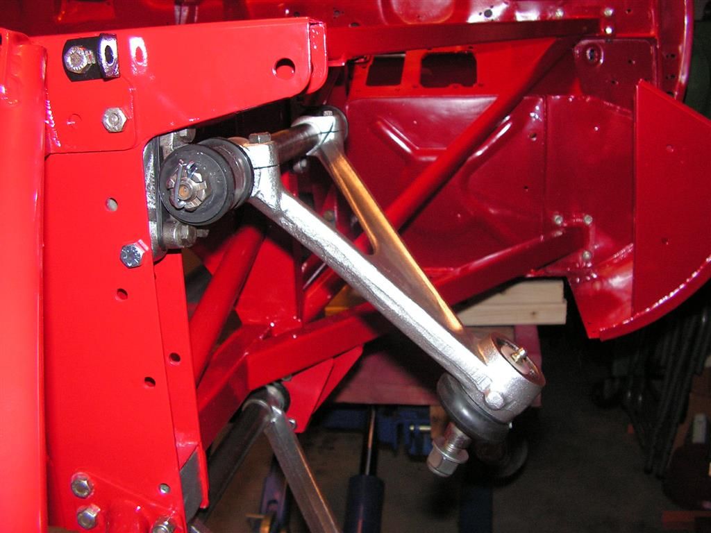

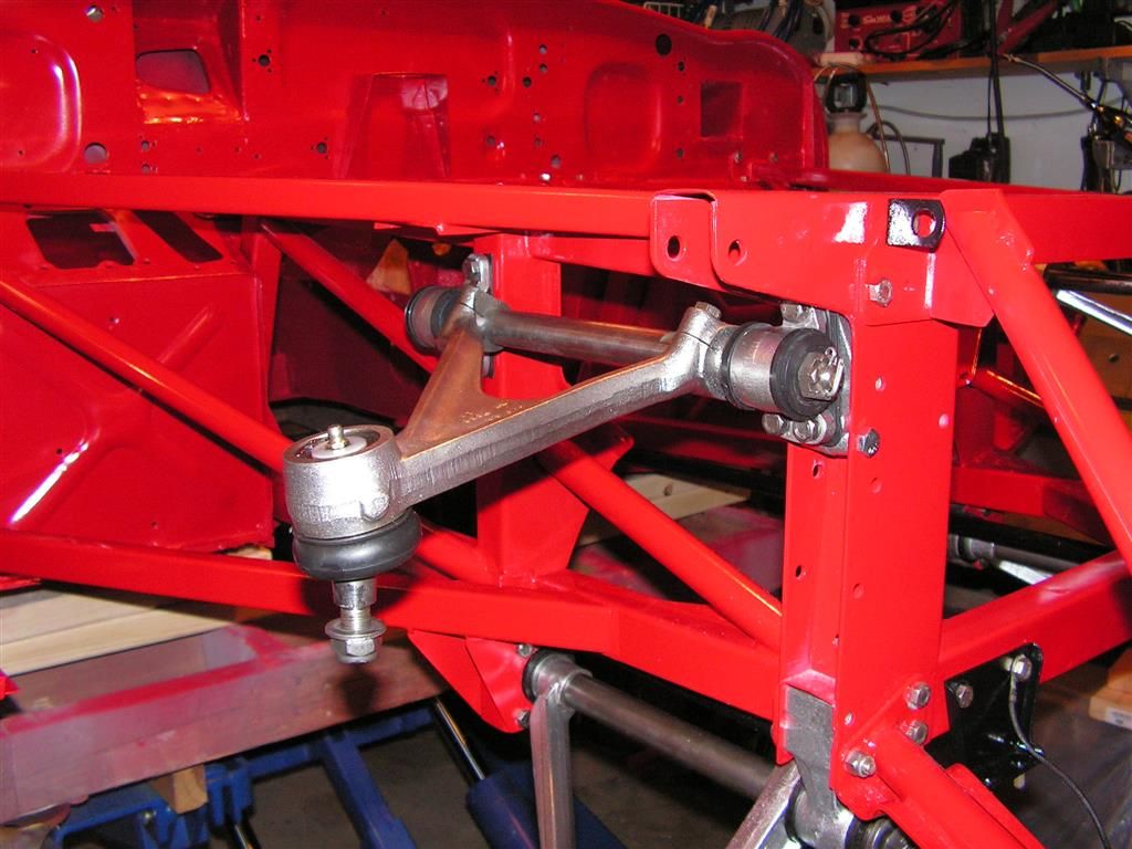

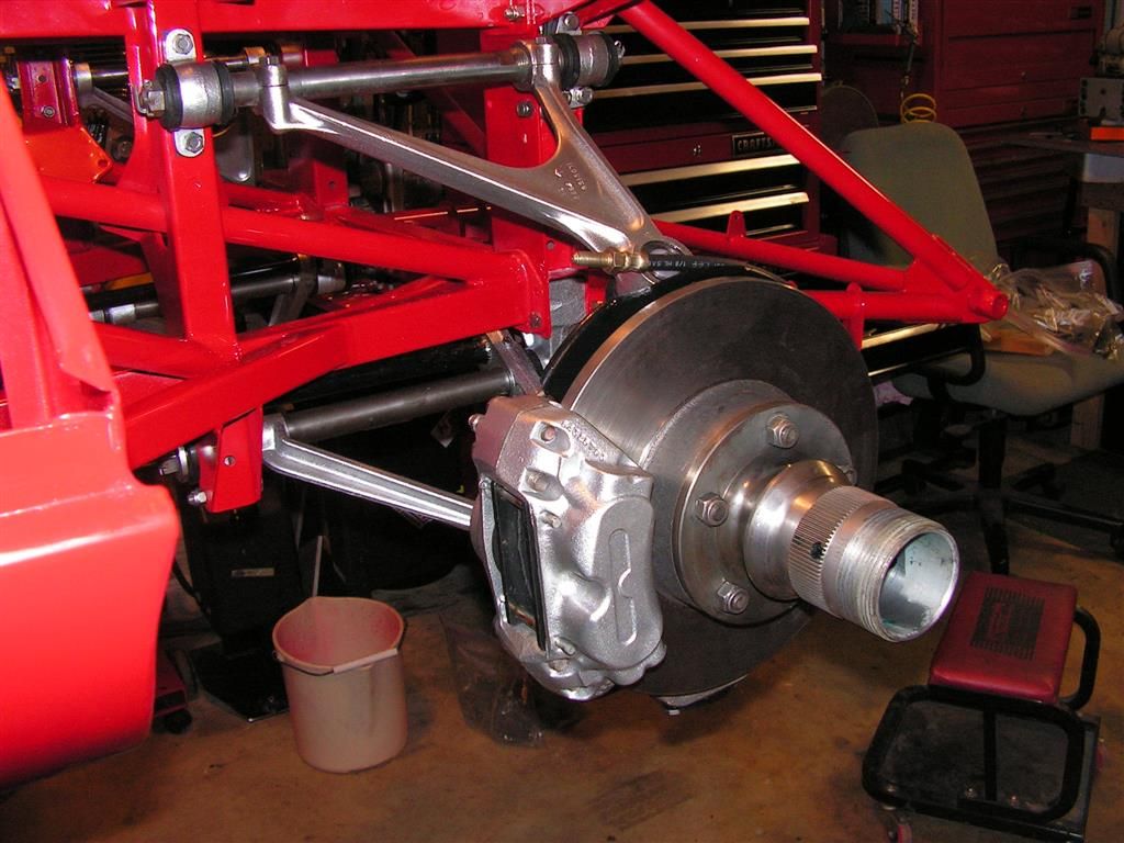

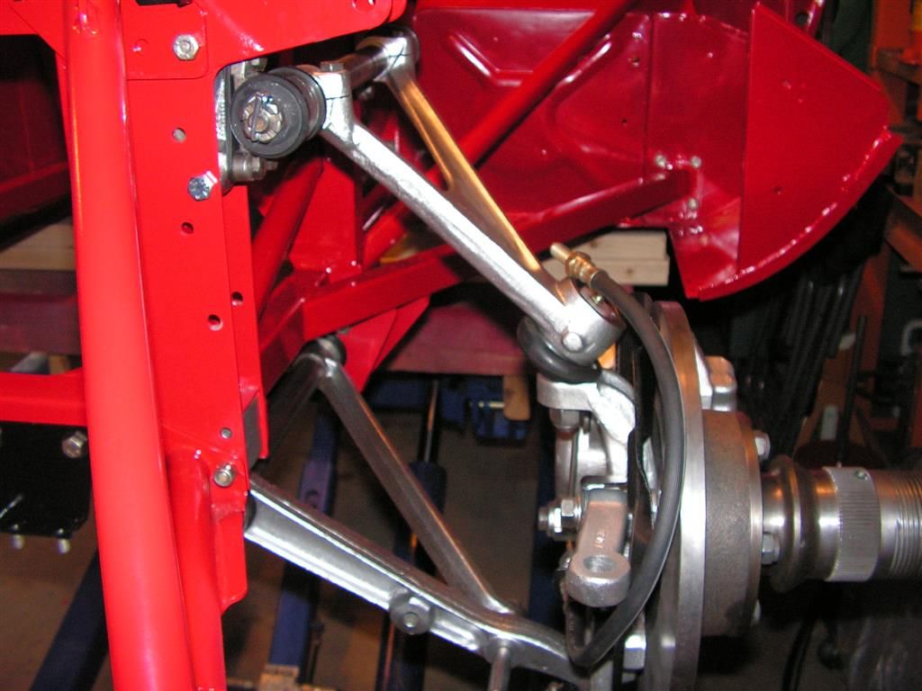

I was able to get a lot accomplished. First up were the upper control arms. I had originally cataloged the number of camber alignment shims to get the rebuilt car back into some semblance of alignment. It will be good enough for testing purposes.

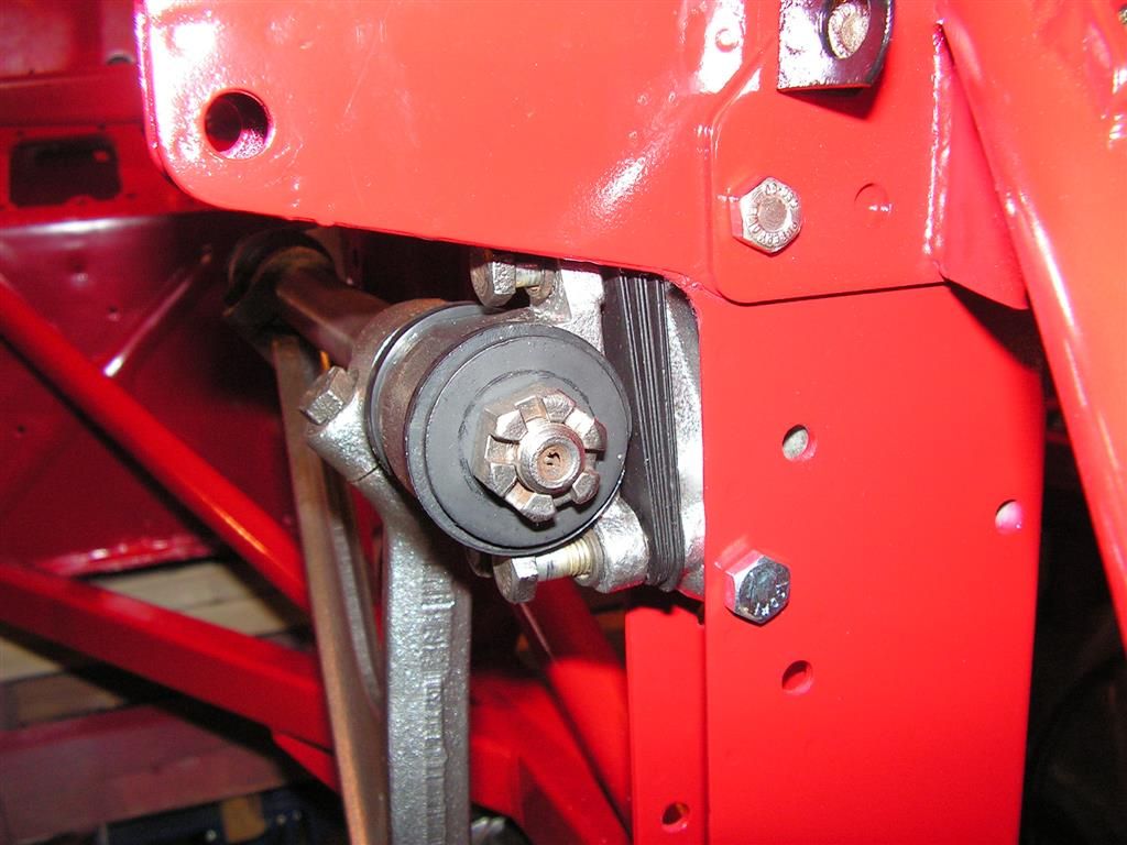

One thing I do to all of my old cars is that I paint the alignment shims because they are a very likely to start major rust spots on the frame if kept in bare metal. Here's a sample of what I mean.
I was surprised to find that number of shims that were originally in the front part of the upper control arms --
A little bit of tweaking and both control arms were installed in no time.

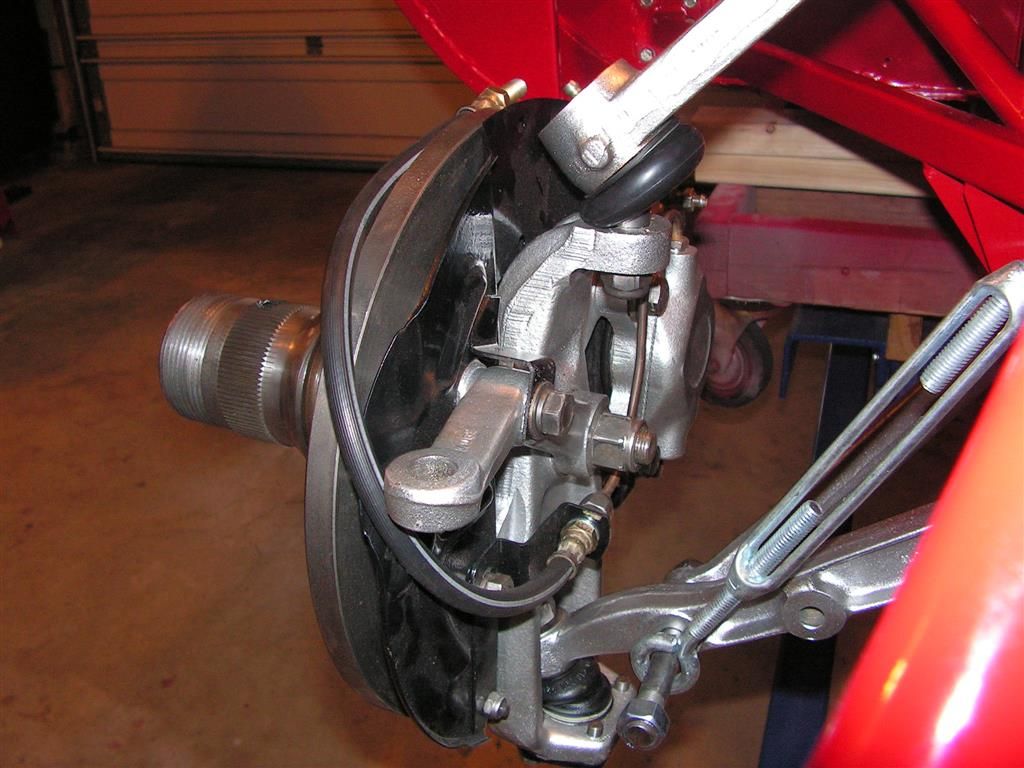

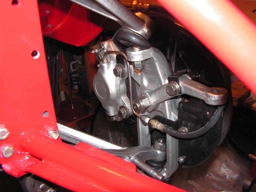

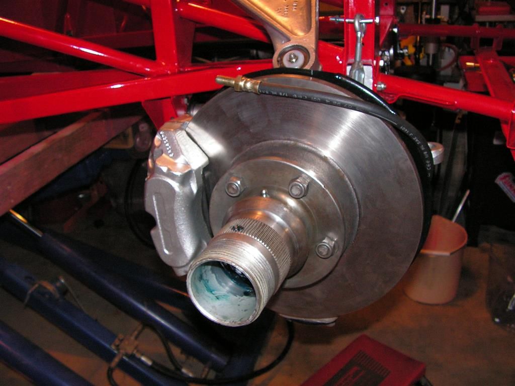

Next up were the front hubs. I rebuilt these things five years ago and they came out of storage good as new.

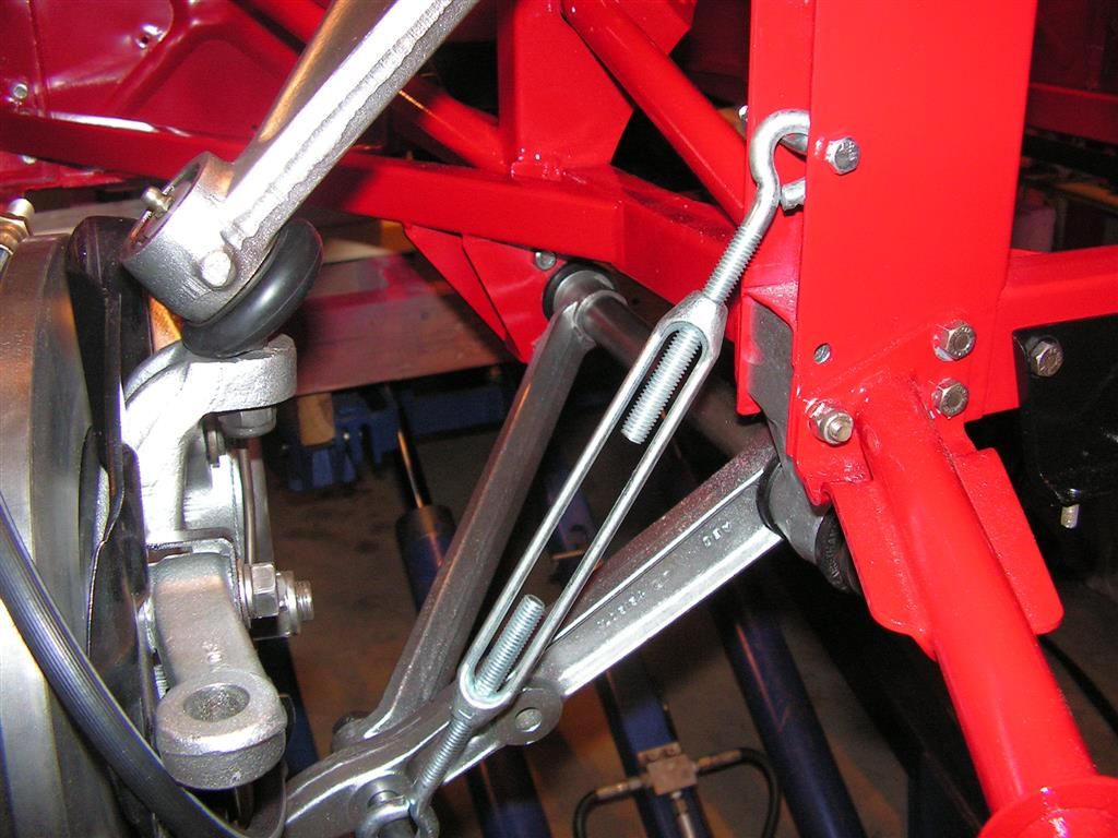

Since I have very stiff torsion bars and there is effectively no load on them (i.e. no engine weight) to help compress the lower control arm, I used a turnbuckle ( bought it at the hardware store years ago for just this purpose) to put the torsion bar under tension and to lift it up far enough to allow the upper and lower ball joint to be installed.
That worked pretty well -- and as usual, what really eats up time in the process is tightening all the fasteners with hand tools to make sure that the paint doesn't get scratched.
Both sides moved along without much effort -- when the early morning light was finally creeping into the garage, I had just finished both hubs.
I was a bit tired at work this afternoon, but the early morning work in the shop was quite peaceful and inspiring. I think even the dog enjoyed it.

Checking in to see how it is going, and it is going. Nice job on the safety wire  thumbsup2
Self-esteem: Does not make up for a lack of common sense. There is such a thing as a stupid question.
Online Uncle Buck
  • Posts: 13382
  • Location: Kansas-Flyover Country!
Re: Starting the final assembly on the E-Type - updated 4-8
« Reply #13 on: April 09, 2015, 10:25:46 PM »
OK, I have looked through those pictures about 4-5 times now. Where is the safety wire you spoke of? I could not find it for the life of me.
Online goodfellow
  • Posts: 13104
  • Location: Northern Virginia
« Reply #14 on: April 09, 2015, 10:28:16 PM »
Caliper retaining bolts -- right by the brake line.
