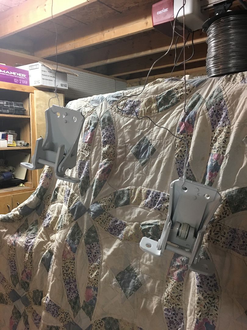

I mentioned yesterday that I picked up some seats from craigslist.
they look pretty nice.  They are not new obviously but they are leather and they match.  there are no holes in them, and overall they look pretty darned good.
since I was under the car I unbolted the seats from the subrame connectors and then after supper I pulled the old seats out.
the carpet is kind of stained but I used some heavy duty carpet cleaner and a little elbow grease and it cleaned up ok.  this is after I worked on the drivers side.
then I pulled that passenger side rear quarter panel off and cleaned and lubed that window regulator.  hopefully it will work better now.
so then I put the rear seat in, I just had to drill two new holes for the rear seat back anchors.

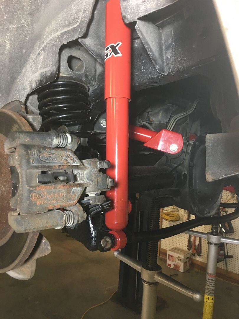

then I put the car on the lift, pulled the wheels off and started removing the rear control arms. first I supported the axle with my screw jacks. then unbolted the shocks in the trunk. then removed the rear sway bar and swapped the speed nuts to the other direction as they say to do on the LMR website. then I sanded it down and painted it with vht black paint.
then I removed the shocks, and the springs, and tried to remove the bolts from the lower control arm.
and this is when things started down the typical murphy path every project I do seems to follow lol. now in the video they just unbolted the lower control arms and they came right out, but that was not how it went for me lol. the bolts had seized inside the sleeves of course. just like trying to remove the leaf springs on my 65. what a pain in the butt. I ended up having to cut the heads of the bolts off with a 4 inch angle grinder and then drive them out with an air hammer. but I finally got them out. both sides had to be cut out like that. the upper part came out easier. so once I removed the lower control arms I cleaned up the mounting brackets with brake cleaner and a steel brush then painted them with rustoleum gloss black. then after that dried we put the new lower control arms in place. then removed the uppers and put them in place. everything went fine until the last control arm. for some reason the last metal tube that went inside the upper bushing was 1/4 inch longer than all of the others. now I know the later model cars had a larger bolt and sleeve, and this one was the correct one, it was just too long. so I had to cut it off a bit to get it to fit. once I had massaged all that and finally got the upper control arms in I put the new lowering springs in.
here is a little tip for anyone doing this. it is probably obvious to everyone but me lol. anyway when putting the new springs in, I dropped the screw jacks all the way out and tried to put the new springs in, It was a struggle until I got smart and put the screw jack back in on the opposite side and lifted the opposite side up, that dropped the side I was working on enough to get the new spring and isolater in easily. then repeat on the other side.
after that I installed the new kyb agx adjustable shock and the sway bar. the instructions do not tell you how the heck you are supposed to mount the emergency brake bracket back to the sway bar mount now that the bolt is coming from the other side. There did not seem to be enough threads coming through to get a nylock nut on there so I went to orshelins and bought a couple longer 10mm bolts and nylock nuts and that worked perfectly.

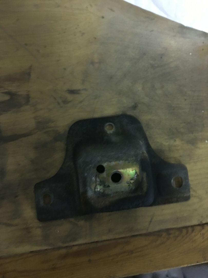

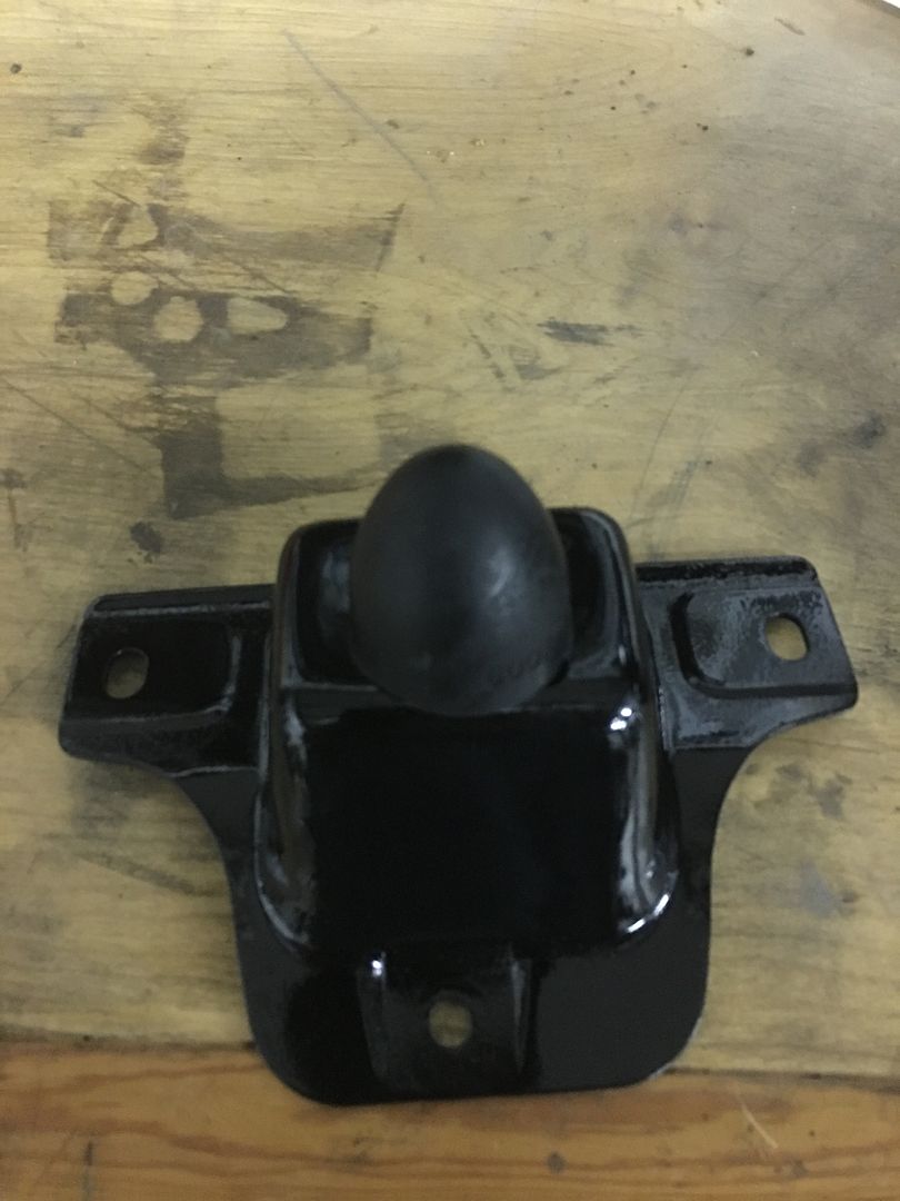

then I removed the pinion snubber bracket and removed the old snubber from the bracket.
then cleaned and powder coated the bracket and installed the new snubber.
bolted it back in. torqued everything but the bottom bolts on lower control arms to 60 foot pounds. put the wheels back on and dropped it on the ground to torque the lower control arms to 60 footpounds.
and finally I am done. with that part. tomorrow I will tackle the front. hopefully it will go a bit smoother, but knowing me I will not be holding my breath.

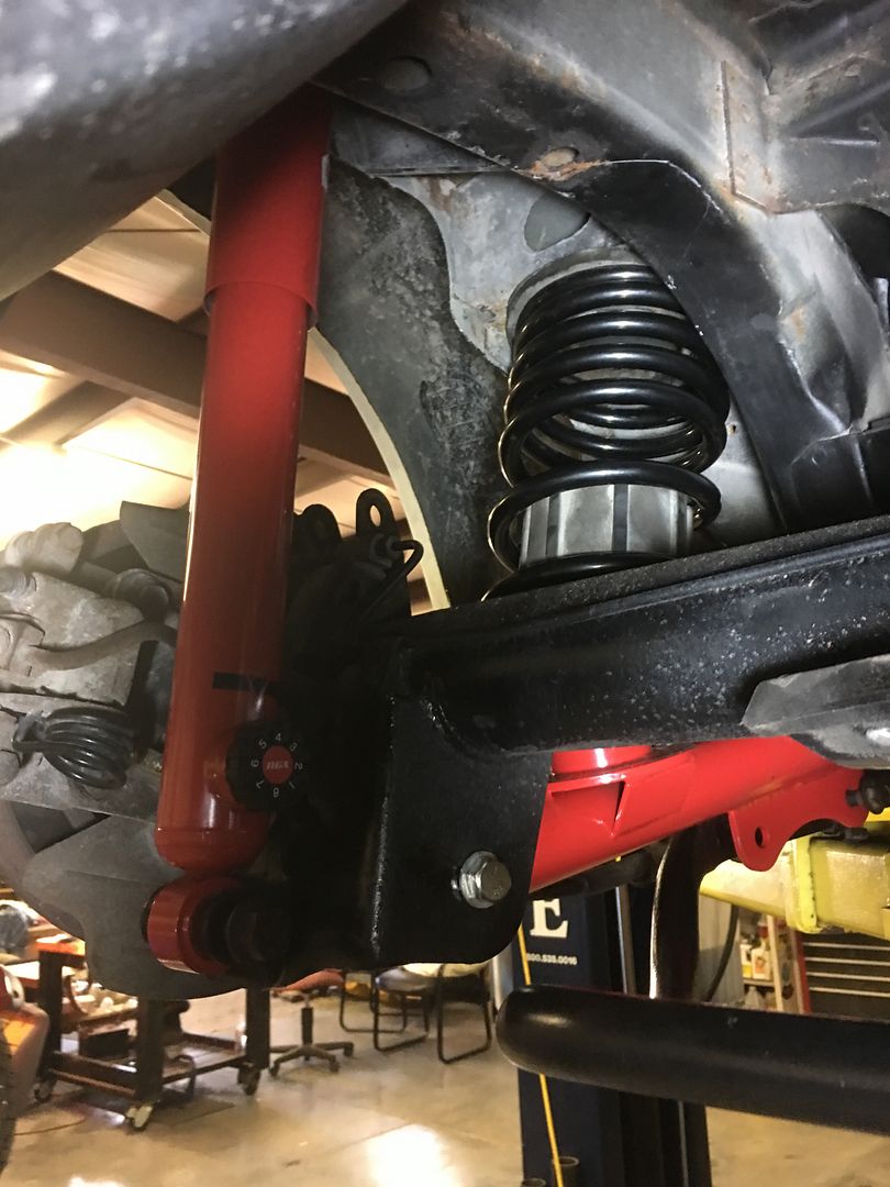

well if anyone who reads this thread has ever installed lowering springs on the front of one of these cars they will know that I have never done it before or I would not have been so optimistic yesterday lol.  no this did not go easier than the rear springs in fact it took me even longer to finish.  but I did get it done.
first I put it up on the lift, pulled the front wheels, and then put a jack under the lower control arm to load the spring.  then I removed the upper strut nut with a 1/2 inch drive impact.  so far so good.  then I removed the abs mounting bracket, and the two bolts holding the strut and removed the strut.  easy peazy.  then I removed the 2 15 mm bolts holding the brake caliper in place and wired it up out of the way.  then I removed the abs sensor, then the sway bar nut and dropped the jack.  then I simply removed the spring,,,, ok not so simply.  I pried and cussed and pried and could not get the spring out.  so I went to oreilly's and rented an external spring compressor and came back and could not get it to work.  so I just tied a ratchet strap on it to keep it from exploding out at me if it should suddenly give way and just let my mad out and pried it with two long pry bars until it finally came out.  that took me hours.  so then I cleaned it up and went to put the new spring back in.  I decided to leave what I thought was a spring isolator in the control arm but there was simply no way to get the spring in there.  so I decided to remove the isolator.  that was when I finally realized why it was so hard to get the spring out.  I drove a 3 inch pry bar under that isolator and pried it up, put in another and drove it in, pried up, and slowly moved around until I finally got that stupid thing out.  this is what I found.
It wasn't a spring isolator, and if I had ever done this job before I would have known that lol.  the stupid spring had rusted so bad it was rusted in two.  I literally had to pry that last ring of the spring out of the a arm like it had been welded in there.  It should have just fallen out.  I think that the previous owner must have parked this car with the drivers side facing north for years and let snow and crap just rust that side completely.  it was the drivers side in the rear that was the worst as well.
anyway I finally after several hours got the new spring in, unfortunately I discovered that the drivers side ball joint was also shot.  so I asked my wife to go back to oreillys and get 2 ball joints and there ball joint compressor. in the meantime, I pulled the other side apart, it was so much easier, it was like I had done it before lol.  then I  watched a couple utube videos and tried to replace the ball joints.  unfortunately the ball joint compressor was not big enough.  the hole that the ball joint stud was supposed to fit through was too small.  I made it work anyway.  but it was a struggle.  I had to get out my big breaker bar to get the old ones out and new ones pressed in.
but once I finally got those replaced I went back to oreilly for another trip, took back my rented tools and got some new sway bar endlinks.  came back and put everything back together.  several mistakes putting things back together. of course.  important safety note, you can't get the stupid abs sensor back in if you have re-installed the strut already.
anyway I did get it back together.
