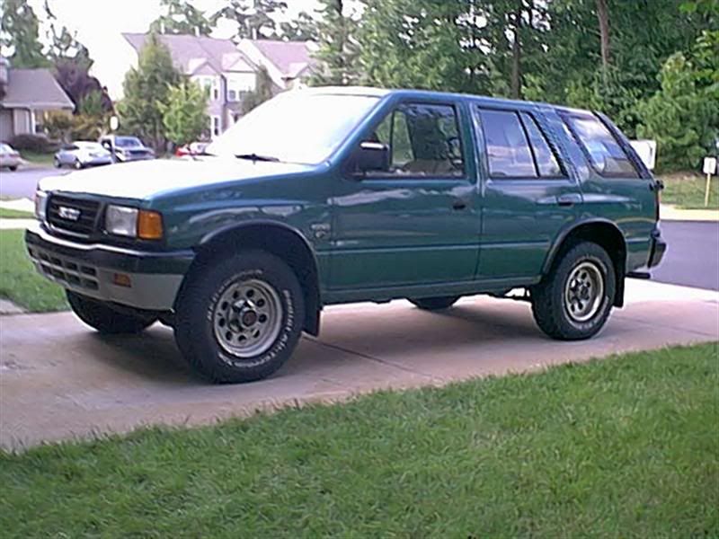

Last car I painted was my '95 Rodeo; I used a single stage polyurethane and my 70's DeVilbiss JGA gun for that job --
