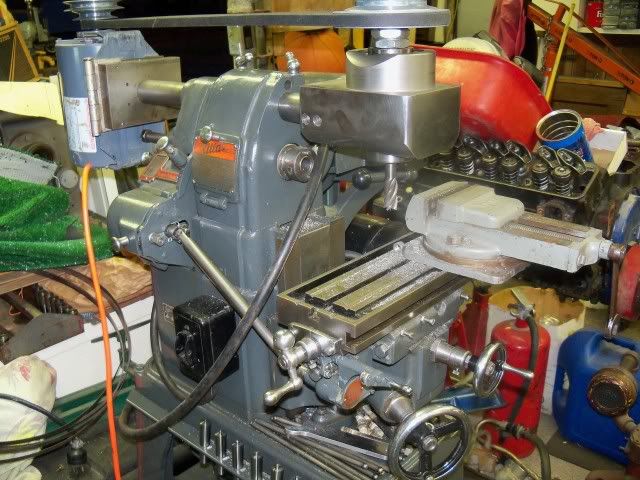

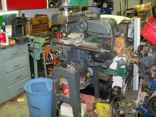

By most machining standards, my little old Atlas is considered a joke, or not much better than a toy by true machinists, and I am sure even a lot of home guys. However, that is alright by me. I like my little machine. The machine that follows in it's original configuration was actually a horizontal milling machine. Well, horizontal is fine, and I can still run this machine as a horizontal, but I decided I wanted to be able to run it as a small vertical meaning I would need to make the accessory vertical head.
I took several semesters of night machine shop class. During the second class, the vertical head was my project. As I am sure you can tell, given it's small size, the machine is only good for projects of a very limited size. As for cutters in the vertical head, I am limited to a 1/2 shank going into Morse #2 taper collets.  If anyone viewing this should happen to have an original vise for this machine, index centers, or a rotary table, please contact me. I would really like to have these original accessories for this machine.
The vise that is actually an ill fit for this machine is from my Atlas 7b shaper, and unfortunately the closest fitting vise I have to use with the milling machine at this time. The motor running the vert head was not originally part of this machine, nor was it part of the original design. Note the picture below, and the black motor on the machines right side. That is the original location, and motor for the machine. In creating the accessory vert head, I actually changed nothing original to this machine. I can remove the vert head and put this machine right back as a horizontal mill in about ten minutes, so as you see it, it could yet be configured either way easily. I would love a Bridgeport, but there is a world of difference in cost that I might never be able to justify, or afford. Until that time comes, if ever, this is my milling machine. The good part is, I only have about $400 total accessories and all in this machine. I know I can always get that much out of it if I ever have to.

If I had the $ I would just buy a new Palmgren "Low Boy vise" which has a very low profile and does not eat nearly so much of the limited working height from the table to the face of the endmill. However, the low boy is not a cheap vise, or at least not cheap for those like me with shallow pocket depth, roughly $225 plus tax new. Old original Atlas vises go for insanely high prices, that much or more last I looked on e-bay. I am sure they are not getting cheaper either!
That is why I am using a vise from one of the Atlas shapers I have, which also go insanely high when found separate from the machines. I am fortunate to have the one pictured. Those vises are so high, that is why I bought a second machine! I lucked out and found one totally complete for $200, which is what the vise alone would have cost me, so I bought the second machine. Someday I will re-assemble the first shaper and sell it to recoup funds to pour back into more tooling for one of the other machines. There is a third shaper I also have that I will show as time permits in another thread, an 8" Shape Rite, a very heavy machine for it's size that I bought for a $20 bill! How could I pas on that? Hence the reason I have three metal shapers.
