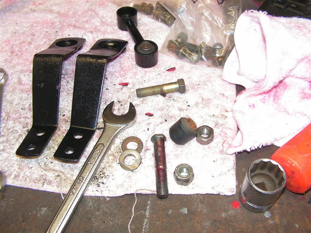

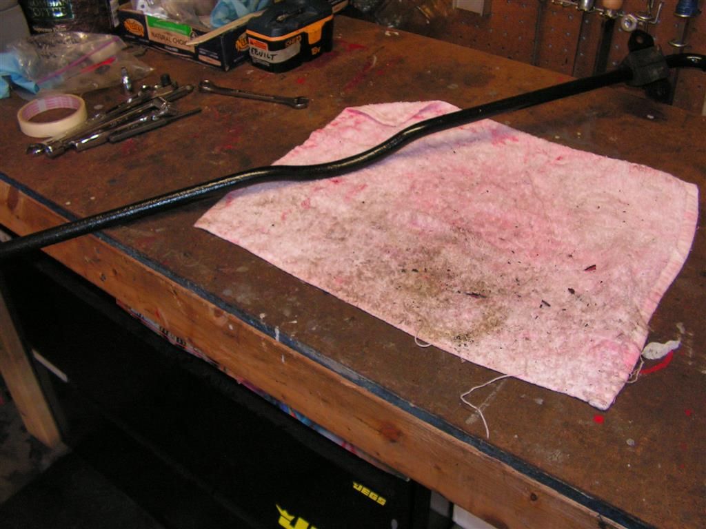

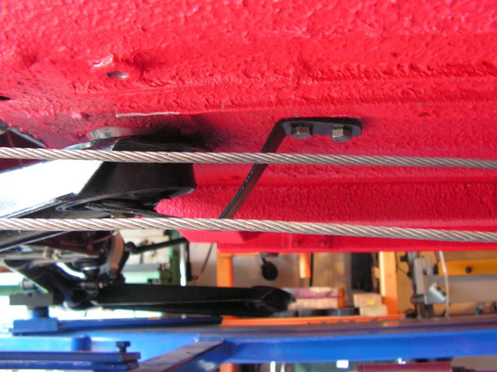

Today I was able to install the rear sway bar, button up the rear end fasteners and and install the radius arm (more on that in a bit).
The sway bar and links were refurbished and the bushings are all new. Hence this was as easy install.
The hardware was cleaned in the tumbler and then wire wheeled. Also, the radius arm brackets and hardware was unpacked and sorted.
These are the sway bar mounts and they need to be cleaned. This bedliner that I used to undercoat the car is tough, so standard thread chasers won't clean well. I keep a well worn carbon steel thread cutting kit in my box for just these purposes. It restores the threads in no time.

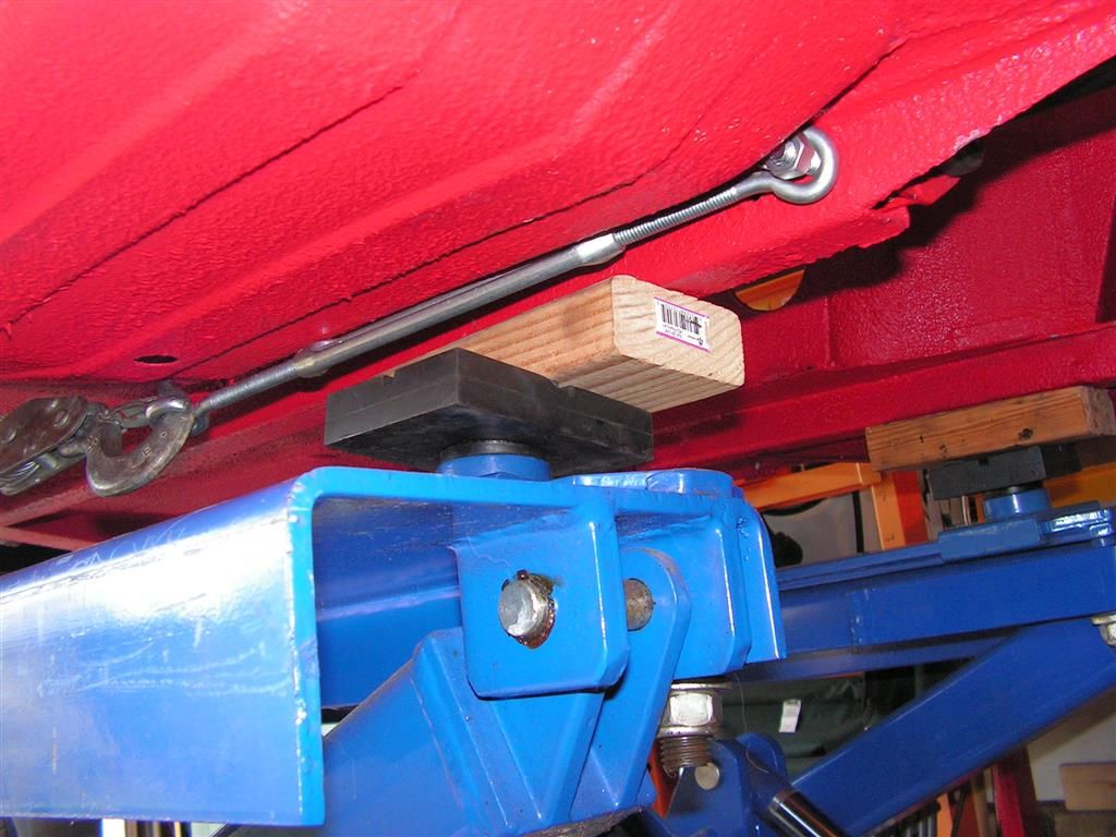

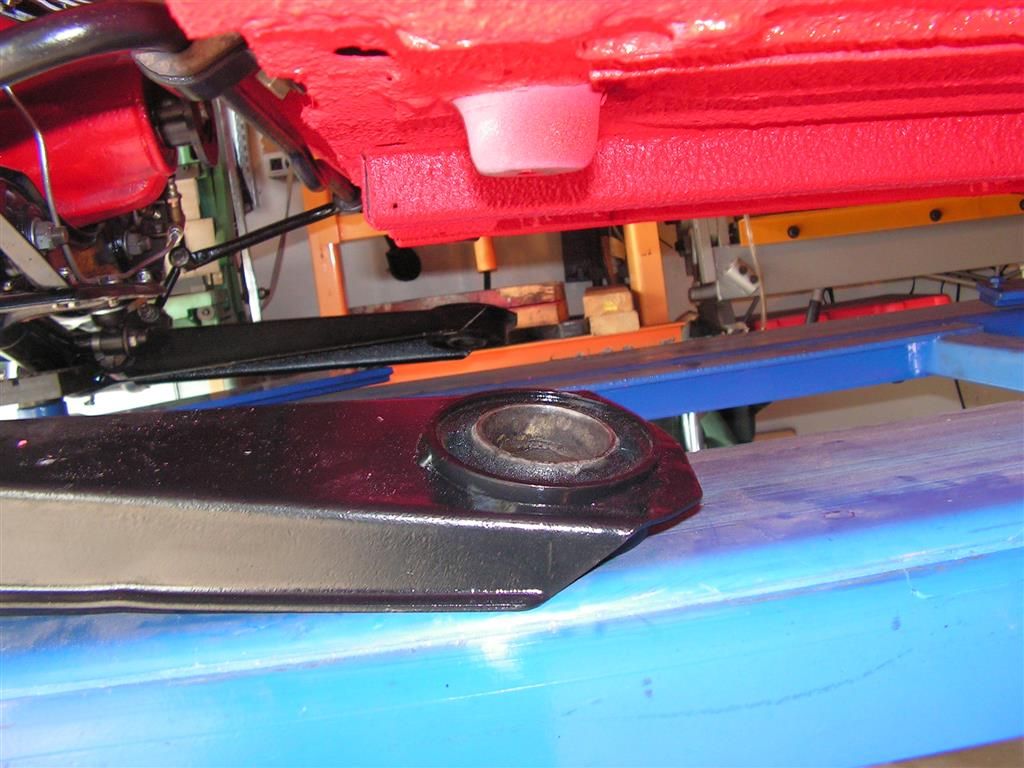

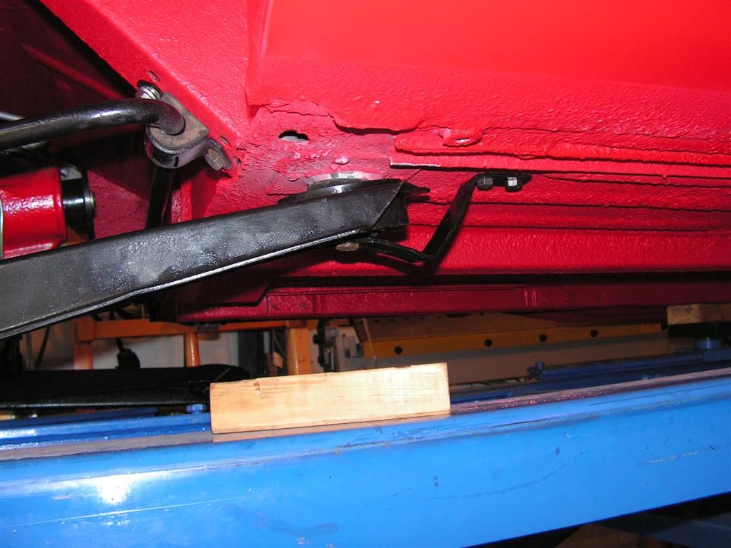

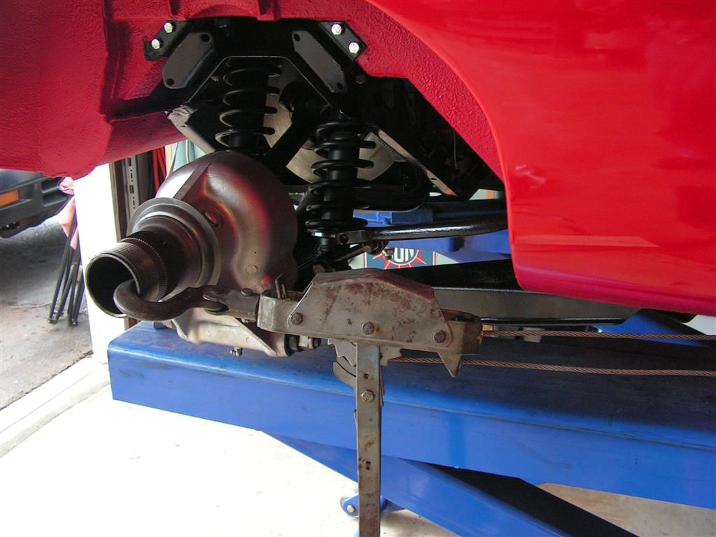

Next is the radius arm and most Jag owner struggle with this installation because it never lines up after the IRS is installed. Some folks actually install the radius arm first and then fight the IRS all the way to install it in the chassis. Well, here is a good tip and it's worked for me for many years. Best of all it takes only a few minutes to install the radius arm.
I slightly loosen the six IRS cage bolts from the IRS mounting brackets (six 1/2" bolts on each side) then I run a large 3/8" bolt though the front subframe mount. My solution is to use a come-along to winch the IRS forward in order to start the radius arm retaining bolt.
First though I cleaned the gunk and paint off the radius arm body mount -- I want nice shiny metal on this mount. Then I covered it with anti-seize.
I hook the come-along onto the rear hub and the front subframe mount and pull just enough to align the radius arm with its mount.
Once aligned, the mount and retaining bracket are a breeze to install.
Total time it took to do this is 35 minutes.
That's about it for today. --- Onward!
