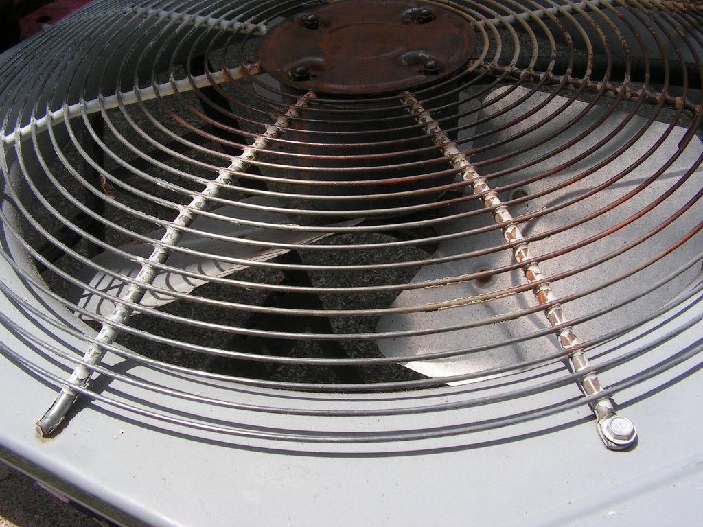

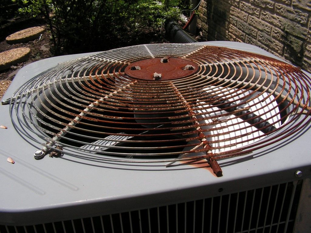

Today I worked on the outside condenser unit. It's definitely in need of attention -- full of leaves and dirt and rusting. It functions well, but I let it go for three years without a good cleaning.

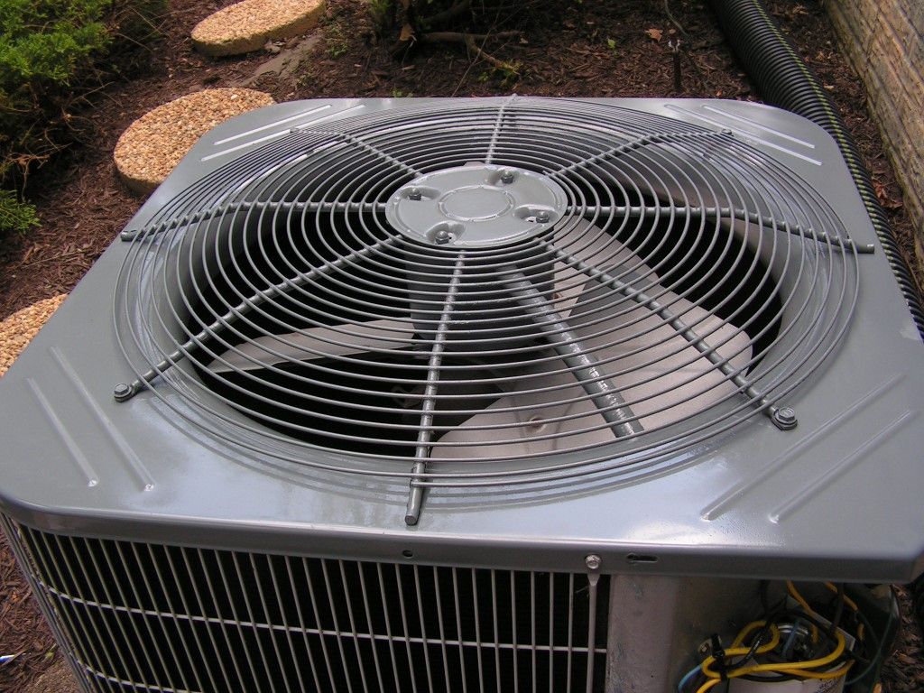

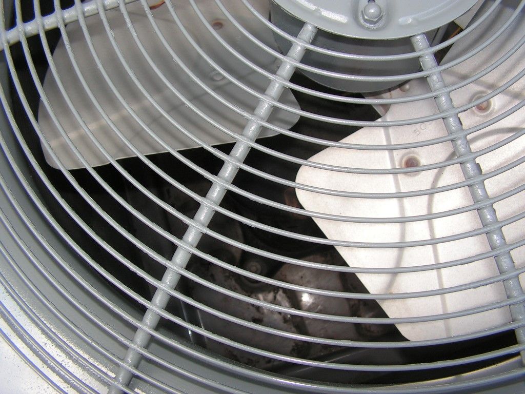

The first thing I did was to pop the fan off the top of the condenser coils and strip the rust and old powder coat. It took a few hours with a wire wheel , but it was eventually clean and ready for three coats of gray implement paint. Unhooking the motor is no big deal -- three wires -- two to the capacitor and one to the contactor.
NOTE -- if you do this yourself, don't forget to kill the power to the outside AC unit and to short out the capacitor before working on it.
Next I vacuumed up the debris on the inside of the unit and opened up the drain holes. I blew compressed air from the inside of the condenser coils to clean the debris that had lodged in there for several years, and finally hosed it down with some cleaner to get the remaining gunk.

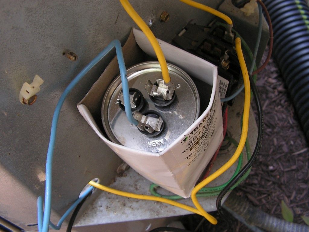

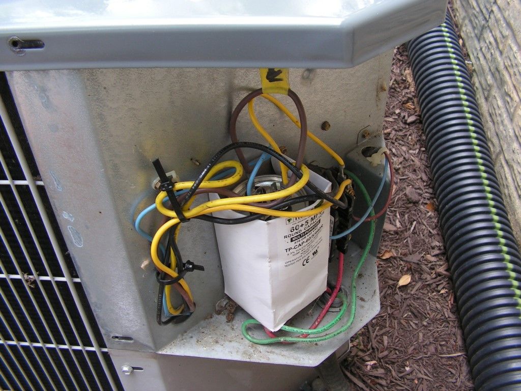

For good measure I cleaned the contacator with CRC electrical contact cleaner and I replaced the capacitor because the old one was looking a little rough -- corrosion at the terminal has taken its toll, and it had been in there for quite a few years. The HVAC techs will charge an arm and a leg for these things, mine was around $30/shipped several years ago, and I just ordered a new replacement for $20 shipped. I try to keep a spare on hand in case the thing blows out in high summer heat.
Everything bundled back up and the fan is ready to be put back. Took about four hours to do the whole job.
Ready for the season --
clean on the inside .....
and the outside --

Are you going to keep that cap nicely tucked away in the box? Seems a bit of a moisture magnet to me.
It's dry -- and the boxes have always come out in good shape. I keep the boxes in there to remind me what the specs of the caps are in case I forget -- or misplace the info.
